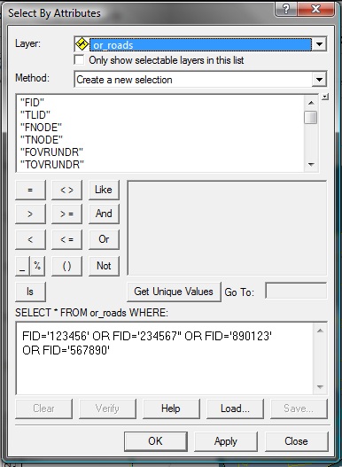

Hi,
I need to write a script that would extract the contents of a text file (see below)
123456
234567
890123
567890
and would write a script that later could be loaded when using "Select by Attributes" tool (see below).
P.S. I have a list of hundreds of numbers that I do not want to enter them one by one.
Your help would be greatly appreciated.
Thanks

Ariel,
if you have your list in a text document you could load it in to excel so each value is in separate rows down one column.
then create a formula to create your expression, e.g:
= "FID = '" & A1 & "'"
where A1 is the first cell that contains a value. Copy the formula down so that each row gets populated. If you the copy the values into notepad then copy and paste them into word ( this stops the column being added as a table in word). You can then do a find and replace to add the 'or' segments into your expression. ^p in word is hard return replace this with space OR space. This should give you your full expression that you can then paste into arcmap.
hope this helps
anthony

ArielCarballo
Deactivated User
Anthony,
Thanks for your prompt response, I'll try it.

ArielCarballo
Deactivated User
It worked perfectly!! Thanks a lot!!
