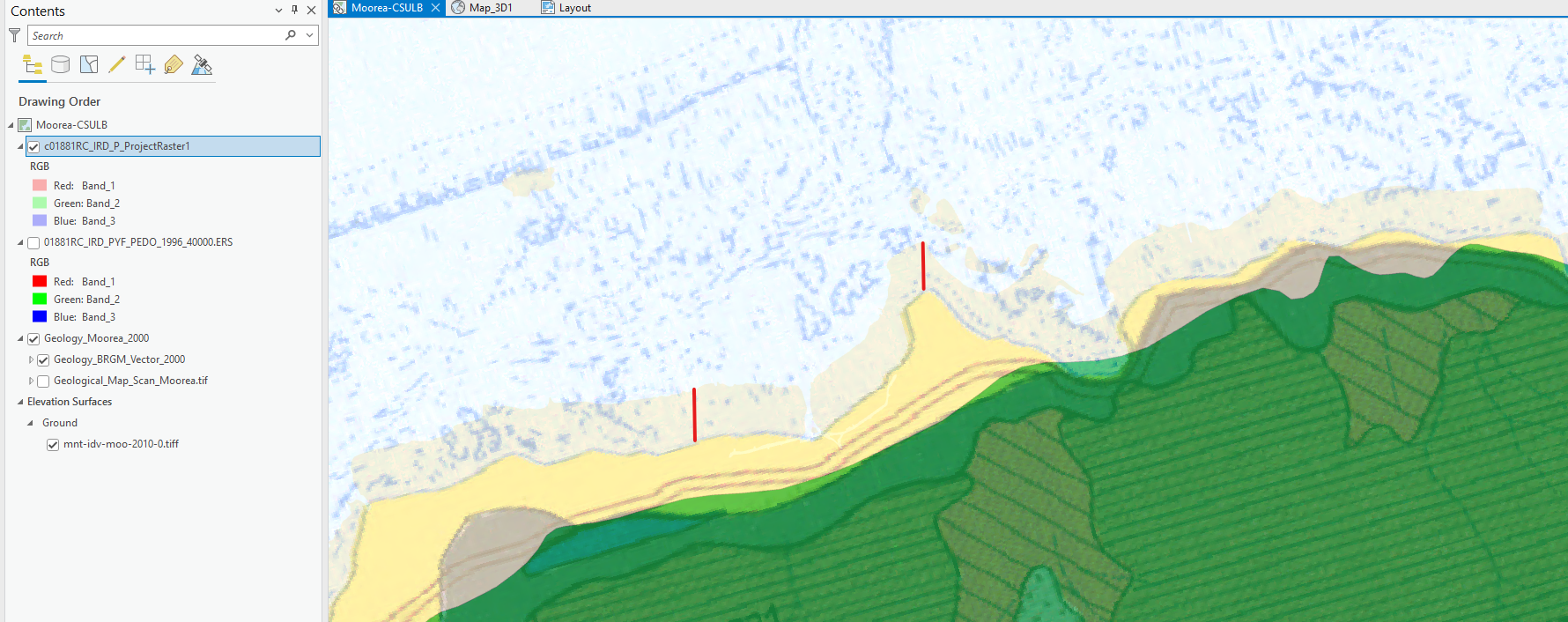

Hi all.
I am using ArcGIS Pro 3.0.2
I am trying to reproject a raster from WGS1984 to RGPF. The Project Raster tool runs smoothly but the projected raster is still off, like the original raster.
When checking the spatial reference of the projected raster, it indicates the correct projected coordinate system /geographic system. However it's still not aligning with the other layers, which are in the RGPF system.

And a screenshot
