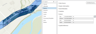

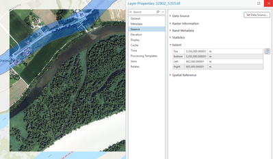

Hello there 🙂
I have a question regarding the output raster of the Clip Raster tool. Specifically, I need the new extent of the clipped raster, excluding NoData values. However, the resulting raster always retains the same extent as the input raster.
Since I need the clipped raster for further processing, I’m looking for a solution to reduce the extent accordingly to optimize processing time in upcoming analyses.
Is there a way to achieve this?
Thank you in advance!

you can certainly set the output extent of the clipped raster
What parameters did you use for the tool?  defining the output extent can definitely be accomplished using the appropriate parameter settings.  compare the options you used with the parameter functions in the help topic

Which version of ArcPro are you using (by the way you should always mention such information)? The clip raster tool worked correctly for me resetting the extent to the clip. I'm using 3.4.3.
