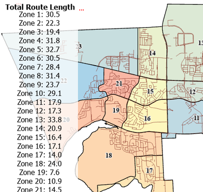

by Anonymous User
Not applicable
Here's a snippet of some of my current zones. You can see the Total Route length on the left i.e. length of road in each zone. I would like to create new zones where the total distance of road is approximately the same in each zone.
DuncanHornby
MVP Notable Contributor
OK just thinking off the top of my head, if you read the help file it clearly states it only uses points or polygons as input.
How about extracting the centroids of the lines, attaching the length of the line to them and then running the BBZ tool but using your length value as the input to Attribute to Consider parameter? I've never used that tool so what I might be suggesting is not appropriate, but worth ago I think?
