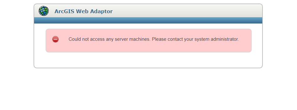

When the tool is exposed to real examples, it start receiving long strings, it means really loooong strings.
For this case it is send an string with 9.220.000 characters approx. and the service answer is:

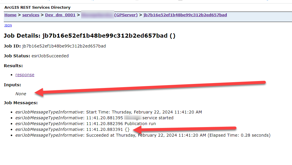

When the log of the server is check, it indeed create the job and try to process it, but the Python code of the tool never receives the parameter (As can be seen in the 4th message - it should prints the parameter):

Hello Alexander, as you state, and under my knowledge this string is about 9 Mb.
taking into account your proposed solution I can state that I have a WebAdaptor configured in IIS 10, it allows by default 30Mb as maxAllowedContentLenght, that should enough for this use case. As I an using a POST call, the size of the limit on the query string should not affect.
do you have any other suggestion?
