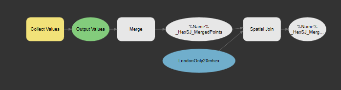

Im using modelBuilder to attempt to create polygon datasets for each feature dataset in a geodatabase. Each feature dataset has a set of point feature classes, some for Weekdays (*WD*) and some for Weekends (*WED*):
I want to merge the point feature classes into one (based on wildcard for *WD* or *WED*), then perform a spatial join with an existing polygon feature. This is the model I have constructed so far:
Thing is, whatever I attach to Collect Values, be it a submodel that Iterates Datasets, then feeds that into Iterate Feature Classes, there's no resulting spatially joined polygon feature, or the resulting polygon feature is including everything in the gdb.
What is required to merge just feature classes inside a feature dataset, then loop through a whole geodatabase full of feature datasets?
