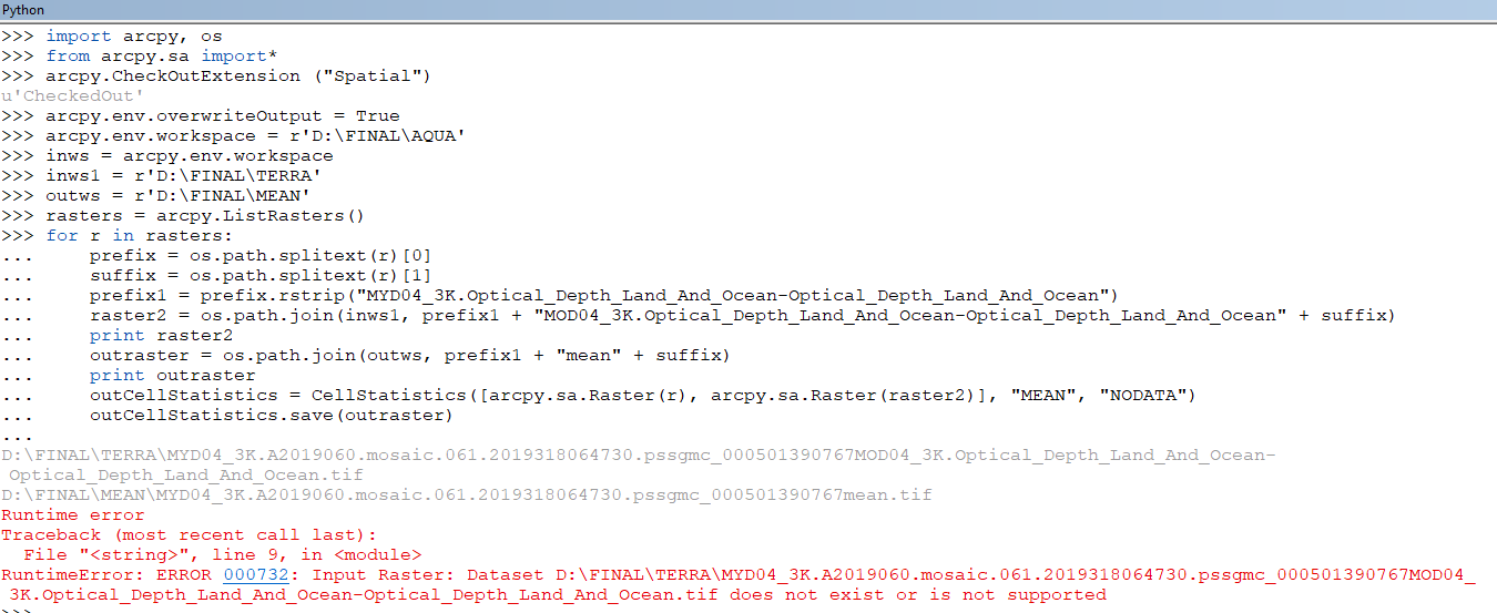

@Lochlan Jones    i too have same challenge but i have to calculate the mean for wo sets of corresponding rasters(each set conatains 136 files), named 'AQUA' (e.g. 'MOD04_3K.A2019060.mosaic.061.2019318071023.pssgmc_000501390776.Optical_Depth_Land_And_Ocean-Optical_Depth_Land_And_Ocean.tif') and 'TERRA'  (e.g.'MYD04_3K.A2019060.mosaic.061.2019318064730.pssgmc_000501390767.Optical_Depth_Land_And_Ocean-Optical_Depth_Land_And_Ocean.tif').
but iam facing this Runtime error
Runtime error
File "<string>", line 7, in <module>
RuntimeError: ERROR 000732: Input Raster: Dataset D:\FINAL\TERRA\MYD04_3K.A2019060.mosaic.061.2019318064730.pssgmc_000501390767.Optical_Depth_Land_And_Ocean-Optical_DepthLand_And_Ocean.tif.tif does not exist or is not supported
LochlanJones
Hi Raviteja, assuming you copied and pasted the error, I think the problem will involve the fact that '.tif.tif' is doubled up at the end of the file it is trying to retrieve from the input dataset. This suggests to me there could be a problem with your formatting or use of splittext as it is taking the full file name with .tif at the end and then adding another .tif. Could you post your code exactly as you entered it?
ravitejaSETTIPALLI
ravitejaSETTIPALLI
This is my exact scenario,if possible please look into that trouble shoot me ,thanks in advance
LochlanJones

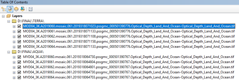

The clue to your problem is in the light grey text towards the bottom. You will notice that those file names do not match with the files you’re trying to retrieve.
You need to make sure the ‘raster2 = ‘ command pieces together a name that matches your input data. It is making the wrong name and then it can’t find that file because of it so you get the error.
It’s also possible to file names might be too long but give it a go and it might be fine. I can take a closer look at this later on as well. Let me know if that makes sense

SIR I TRIED AS YOU SAID,BUT AGAIN IT WAS SHOWING THE BELOW ERROR,PLEASE MAKE A LOOK INTO THAT SIT
