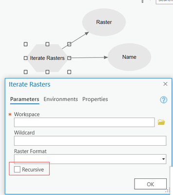

MehdiPira1
@OhtoNygren
Have you checked on the Recursive option in Iterate Rasters before running the model?
You also need to go one level up the folders containing the rasters.
