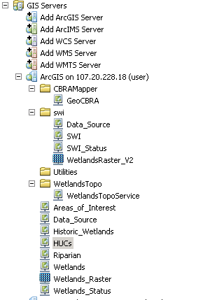

I have an .mxd that has a wetlands layer in it that comes from arc gis online.  I want to intesect this with some features in a file geodatabase from within Arc Map.  I can make a connection to arc gis online in arc catalog and see the wetlands map service.
But when I try to use the Intersect tool, the wetlands map service isn't listed.
Is it possible to use a map service as the input to the Intersect tool?
