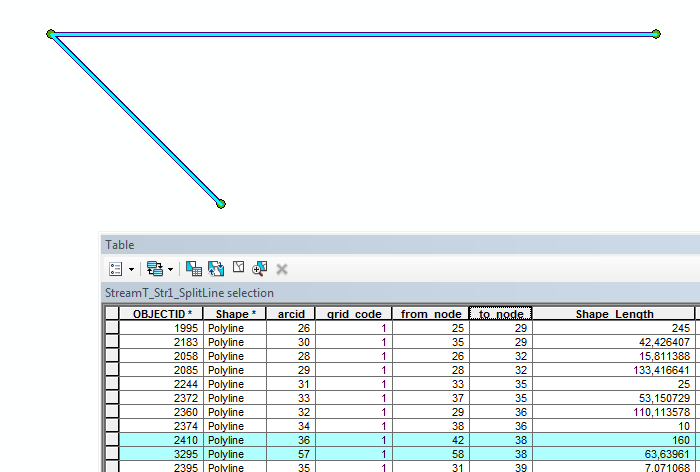

Hi, I have a class of lines and I need to shorten them just from one side to a specific length (that they will be still connected in angle). I have an information about start / end of a line (nodes) in a table and I tried to figure out it throught adding points, but still can´t find a way. Thanks!

Thanks for your response, this works great, but just for one feature. I have several thousands of line features in the class and need to make it for all of them to one specific length. I thought that the solution would be make it throught the start / end points of the line - to create a new lines between points with a certain length. But there is a question how to set the length and also how to create lines just for every two points (field "arcid") from end point of line (lower "objectid"). Anyone have some idea?
