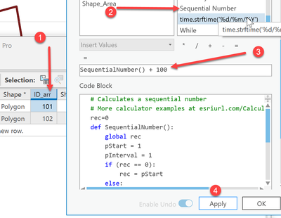

Select your field
just choose sequential number then add what you want and it fills in the code block

Select your field

You have to know where to begin.  The example I gave just added to what was there.
If you want to edit the start number, then you have to change the start value in the code block.
If you want to continue on from a start location, then the quickest is to highlight the rows that you want to calculate the values for, then continue on.
field calculations on work on selected rows.
If you are looking for "automagic" that is a much uglier path and isn't a simple field calculation thing.
If you only have 10 or so to do at a time... manual is quickest.
