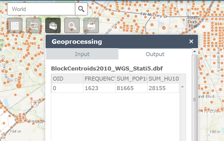

The GP task is working fine, because I added This GP task to the geoprocessing widget in the web app builder and it is doing exactly like I want it:

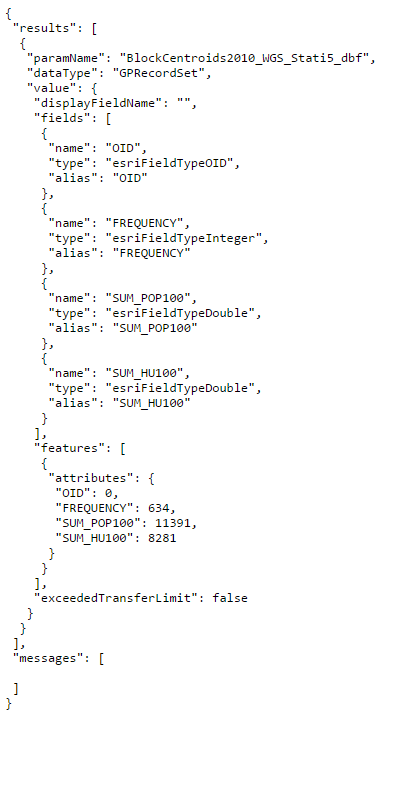

This is what JSON from the service looks like:

    function createSummaryTable(results, messages) {
        console.log("createSummaryTable: ", results, messages);
        var recSet = results[0].value;
        var totBlocks = recSet.features.length;
        var totTotalPopulation = 0;
        var totHouseholdUnits = 0;
        for (var x = 0; x < recSet.features.length; x++) {
          totHouseholdUnits += recSet.features.attributes["SUM_HU100"];
          totTotalPopulation += recSet.features.attributes["SUM_POP100"];
        var htmlSummary = '<table id="resultsTable" cellspacing="0">' +
          '<tr><td>Blocks</td><td align="right">' + totBlocks + '</td></tr>' +
          '<tr><td>Total Population</td><td align="right">' + totTotalPopulation + '</td></tr>' +
          '<tr><td>Housing Units</td><td align="right">' + totHouseholdUnits + '</td></tr>' +
          '</table>';
        dom.byId("totalsInfo").innerHTML = htmlSummary;
