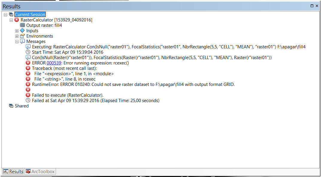

I'm trying to replace no data values within a raster, using "Calculate Raster" tool, but I'm getting an error that I cannot solve.
Here I attach what I am doing, and the error result given.
Error:
Can someone give me a hint on what I am doing wrong?

What version of arcmap?  The error message is common in some environments
41859 - ERROR 000539: Error running expression: rcexec()
In any event, you might be advised to go an alternate route with complex functions
A quick tour of using Map Algebra—ArcGIS Help | ArcGIS for Desktop
do this in the python window and do the focalstats first, then use it in the con statement, then save to disk.  There are example,in the help...just doesn't have that cool interface that the raster calculator does, but a lot easier to save your code snippets to a file for further use and documentation

now your expression is optional, so your IsNull raster is your conditional raster where 1 is true and 0 is false, so you don't need and optional query your fs_ras is the raster it should use if there are null values and the false raster is the original raster.
Now the crux is the error messages.  Did you explicitly set your environments tab on the bottom center-ish of the dialog (anticipating a .... noooo) if not, do so, set the extents the cell size and the snap raster... of course you should have done this for the two previously created rasters... always set everything in the tool, don't rely on global settings.
The folder, is one that exists? and for testing I use variants X as a filename, since X, X1, X2 etc  since you aren't specifying a file extension (like tif), it will create an esri grid.
The old error list is still useful ArcGIS Help (10.2, 10.2.1, and 10.2.2)  and if you go through the error numbers, it doesn't like something about your folder and or filename for the output grid... so have a check, try without the conditional statement.  (if you ever have to use the SQL dialog...type little to nothing and let the dialog build it for you)
