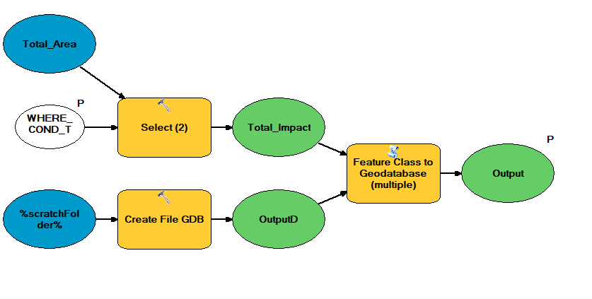

Final Geoprocessing output parameter is not generating Url  to download the file.
1887
02-26-2024 11:10 PM
MohammedAbdul
The model tool is created and Geoprocessing service is published.
The final out put of tool is File geodatabase .gdb and downloads on browser
Kindly assist the final output parameter is not generating Url  to download the file.
ArcMap8.1,ArcGis enterprise 10.8.1
MohammedAbdul
I resolved myself as below ,Just incase it can be helpful to anyone

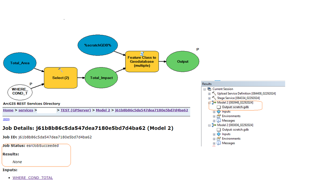

Have you create an output in the scratch environment? %scatchGDB%  for gdb or %scatchFolder% for folder
Solved: Scratch GDB in Modelbuilder - Esri Community
Either shp file or gdb you need to put it in the scratch environment
Hope it helps you
Cheers
MohammedAbdul
Hi,
Thanks for your support.it is updated with scratchGDB workspace env , still output url is not generated in map service as shown below
Kindly suggest
MohammedAbdul
