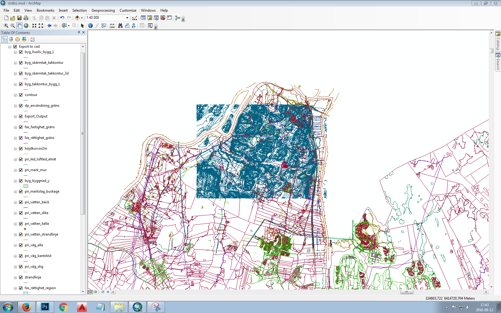

I've been trying to export a map from Arcmap to Autocad for a while. After the command has been executed the contours are found in a new place, as well in arcmap as in autocad.
Before exporting

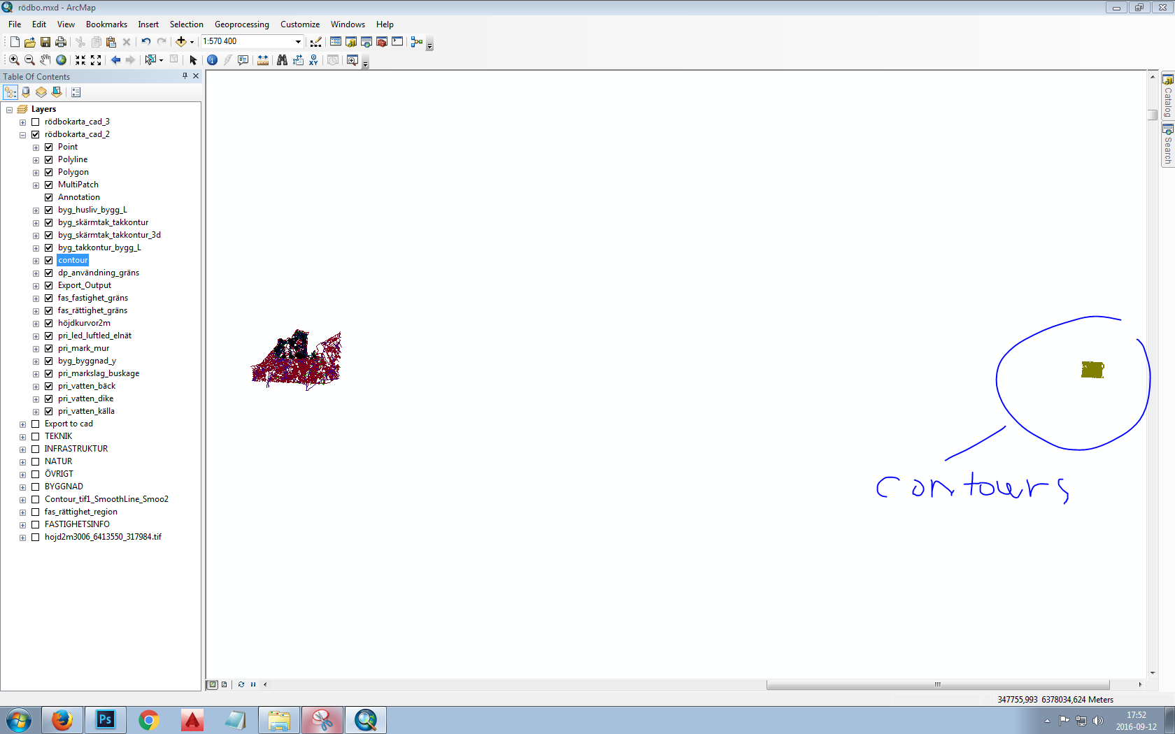

Afterwards with the new layers
Also it should be said that the contours have been converted to 3d, while the rest of the map is still in 2d.
Anyone know what the problem might be?

regional settings... using commas as the decimal separator ... sometimes software isn't set to recognize it or ignores it or it gets unset
