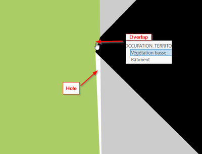

I have a problem with the Eliminate tool (again). Basically, I have noticed that this tool will modify some polygons that are not originally selected. It will end in some holes being created or some overlap in other polygons. Here is an example:

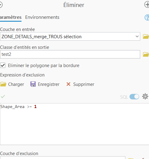

Here are my tool parameter:

UPDATE: No the problem is really the eliminate tool... I have run again my tests and no matter what I do, this tool modifies some polygons to create holes and overlaps
