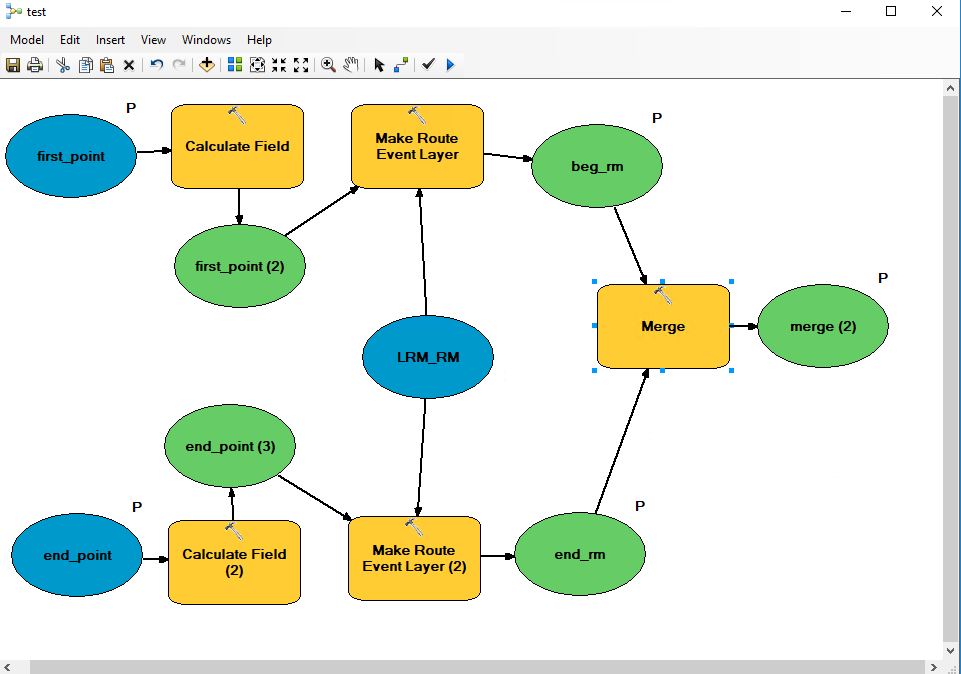

The points were created from another measured layer that has segments for the entire route.  In the above example the segment is C000001E_2 and C000001E_3 with corresponding offsets.  the make route event layer wont work as the measure table have one route name and an accumulated length.   I have created a simple model to create the merge layer that contains the 2 points.
I cant find a tool to create a segment between these 2 points to complete my geoprocessing service.  Any help would be greatly appreciated.

I don't quite understand what you are getting at, and I am no model guru .... but the best i can gather is that you are trying to event map a line.  To do this all that is required is a route, begin measure, and an end measure.
This may help you get started.  About adding route events—Help | ArcGIS for Desktop
