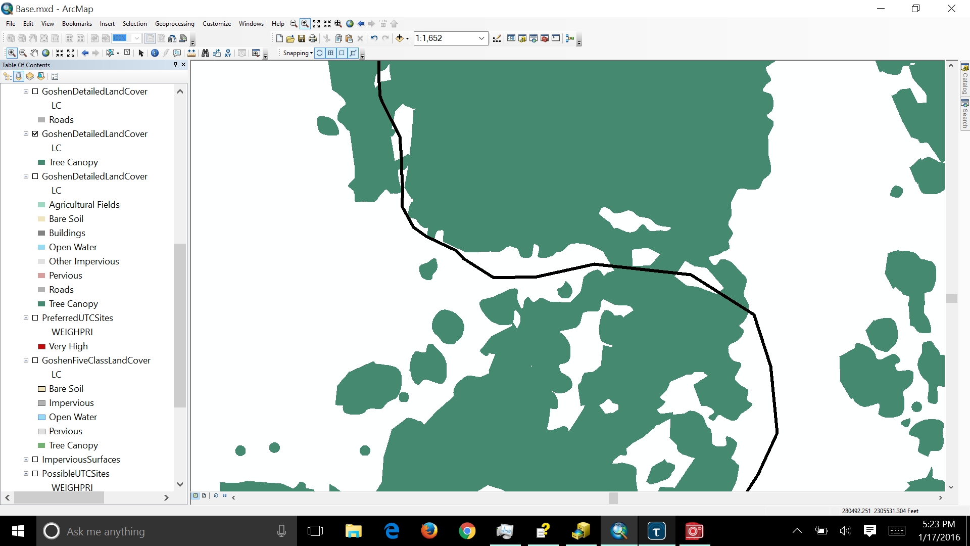

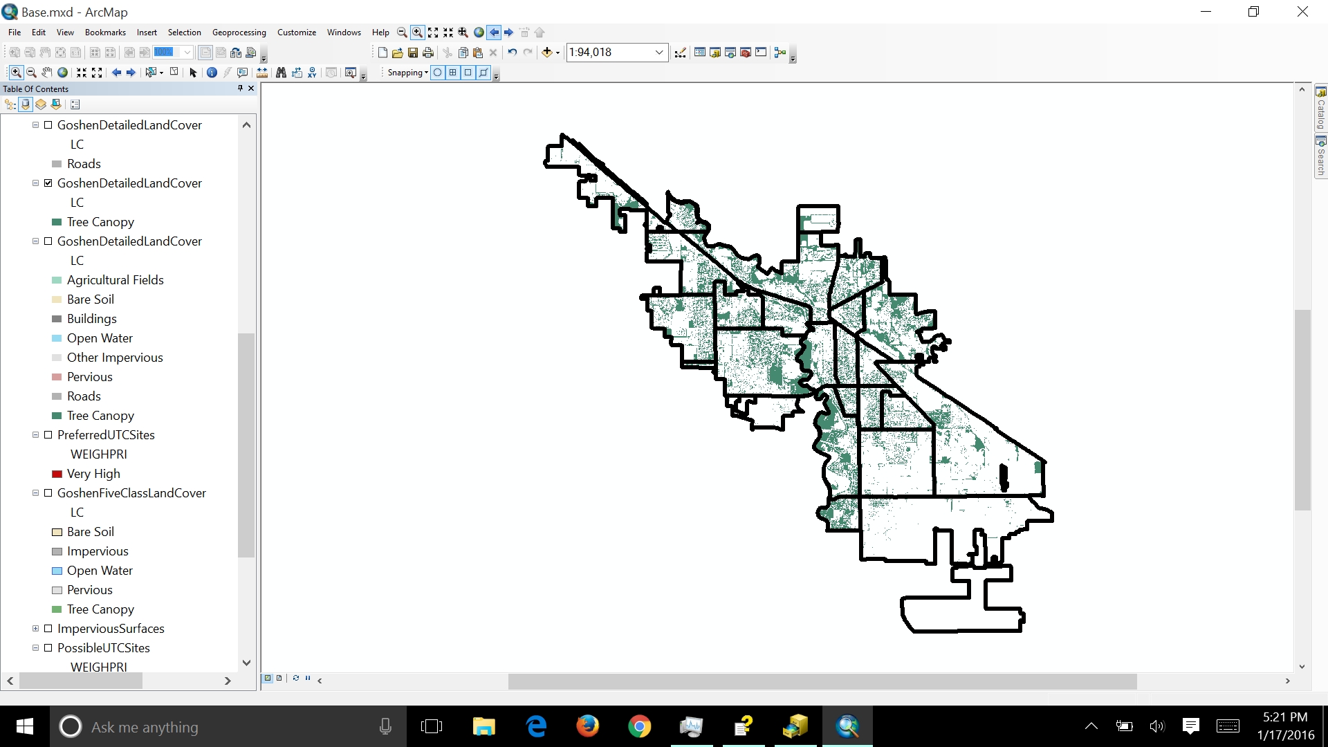

Hi. I have a somewhat convoluted questions that hopefully will be aided by my screenshots. I have land cover data (polygons) available for a small city I'm working with. In the example I'm showing the land cover feature is tree canopy cover. I have the area for the whole city, but I would like to break it down into smaller areas, and I am using block groups since we have other data with those boundaries. The first pic (below) shows the canopy cover (in green) and the block group divisions.Measure1.jpg
The boundaries for the land cover don't match up exactly with the block group boundaries: Measure2.jpg
