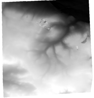

# extract your watershed from the larger digital elevation model
ws_dem = arcpy.sa.ExtractByMask("DEM", "Cutter")

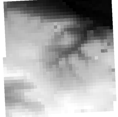

# resample to 100x100
ws_dem_resampled = arcpy.management.Resample(ws_dem, "ws_dem_resampled", "100 100")

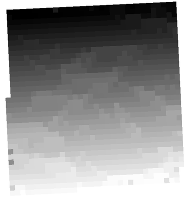

# fill and flow dir
ws_dem_filled = arcpy.sa.Fill(ws_dem_resampled)

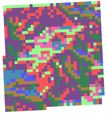

flow_dir = arcpy.sa.FlowDirection(ws_dem_filled)

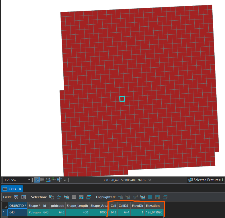

# convert raster to polygons
cells = arcpy.conversion.RasterToPolygon(id_raster, "Cells", "NO_SIMPLIFY")
# extract values into the points and join
arcpy.sa.ExtractMultiValuesToPoints(cell_points, [(id_raster, "Cell"), (ds_id_raster, "CellDS"), (flow_dir, "FlowDir"), (ws_dem_filled, "Elevation")])
arcpy.management.JoinField(cells, "gridcode", cell_points, "pointid", ["Cell", "CellDS", "FlowDir", "Elevation"])
This script will:
  • resample your dem
  • calculate flow direction
  •  Give a unique id to each raster cell
  • Use the flow direction to get the downstream cell id
  • Extract all this information into a polygon grid
