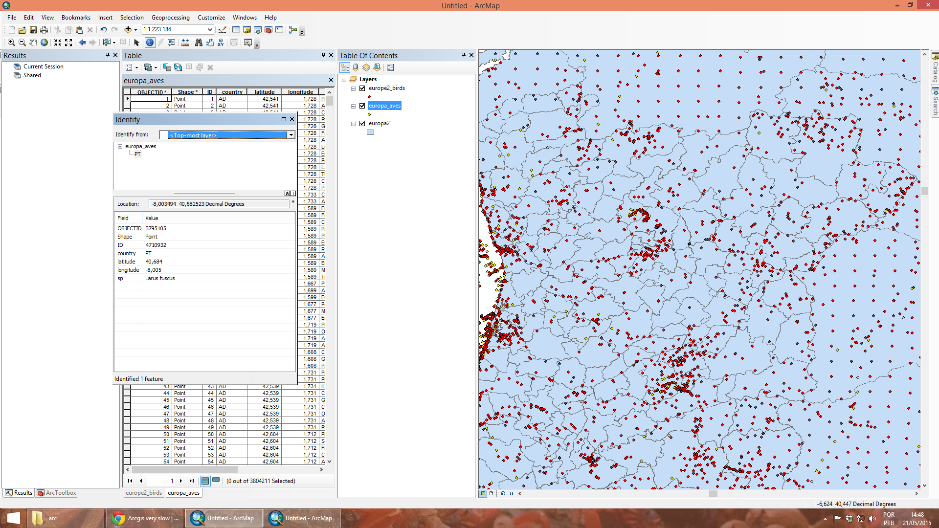

You're right! Join and related is not good to do this. Look at :
The red points are related with in polygons information, and yellow points are original data.
For some reason it excludes some points. I expected to see a full overlay layers.
I will divide these files into smaller shapes!
Thank you all for trying to help me!
