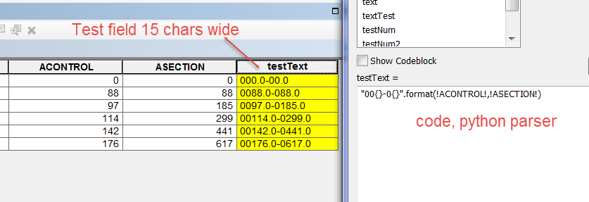

Well there is something wrong with your field then, I have tried it with several records from your table in python IDE itself and in the field calculator on some of my test data...see the image...
I would suggest that you delete the field you are in...recreate it as a text field with an appropriate width (type it in to make sure you get an actual field width)...make sure you aren't in edit mode and try again...something in that process is going amiss.  If that doesn't work, select the first few visible records and try again...if it works now, then you have something wrong with one of the records (is the field nullable??)
Good luck

Grief...an important detail as you can see from the python example below
>>> a = 3653.000
>>> b = 1.000
>>> "00{}-0{}".format(a,b)
'003653.0-01.0'
>>> "00{}-0{}".format(int(a),int(b))
'003653-01'
see where I added the int in front of the a and the b ... do the same around your fieldnames
