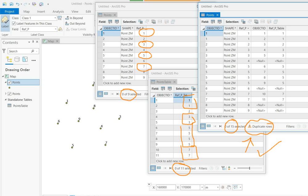

JamalNUMAN
Legendary Contributor
Pro manages to duplicate features according to their corresponding values when performing the “add join” tool as per the screenshot below. I think this capability is enhanced in Pro
