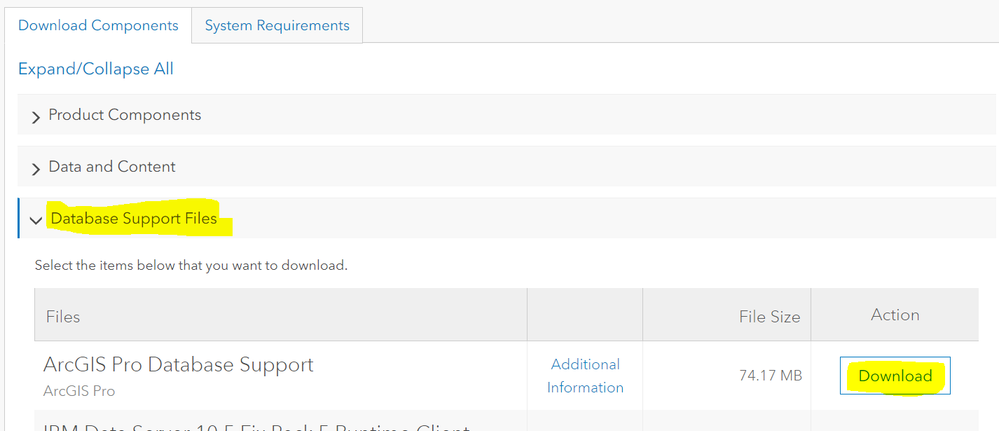

I am trying to upgrade existing ArcGIS Geodatabase in Postgres 10.10 created using ArcMap 10.7.0. I am using ArcGIS Pro 2.6 to upgrade. However, Upgrade Enterprise Geodatabase tool of ArcGIS Pro gives error [You must copy the latest ST_GEOMETRY library to the PostgreSQL software location. Refer to the ArcGIS help topics for more details]
I cannot create a new Enterprise Geodatabase in Postgres 10.10 using Pro 2.6 either. Same ST_Geometry error. All online documentations e.g. https://pro.arcgis.com/en/pro-app/help/data/geodatabases/manage-postgresql/get-started-gdb-in-postgr... asks to download ST_Geometry.DLL from myesri. But I cannot find it anywhere in my.esri.com using my Esri distributor account.
I have ST_Geometry.DLL file in ArcMap DatabaseSupport folder and I copied it to "lib" folder of Postgres. That allows me to create Enterprise Geodatabase using my ArcMap 10.7.1 but not Pro 2.6. I guess I need ArcGIS Pro version and 64bit library. Where I can get it from?

Asrujit_SenGupta
MVP Alum
It should be available on My Esri site.

VishApte
Thanks alot. I could create / upgrade EGDB using ArcGIS Pro 2.6. This fixed my problem.
On a side note, I cannot create EGDB using ArcMap 10.7.1 anymore. Gives below:
You must copy the latest ST_GEOMETRY library to the PostgreSQL software location. Refer to the ArcGIS help topics for more details.
Connected RDBMS instance is not setup for Esri spatial type configuration.
