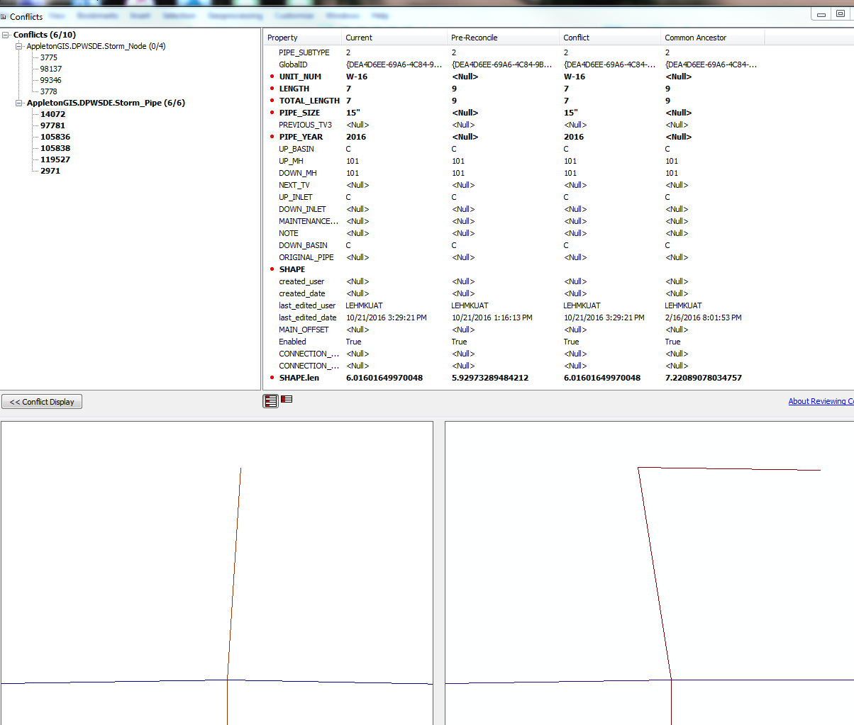

We currently work in a versioned environment with ArcGIS 10.3.2.  We have been experiencing some problems when we posting and reconciling each version.  The User is in conflict with himself.  Doesn't anybody have any idea how or why this could be happening?  Below is an image taken from the conflict manager.  Clearly the feature has been change but because it was the same person editing the feature I can't see how he could be in conflict with himself.

This feature was only edited by one person.  He is the only person that has the new data to update the feature with.  Once at 1:16 PM and again at 3:29 PM on the same day and the common ancestor took place about 8 months ago.  Thank you for your help.
