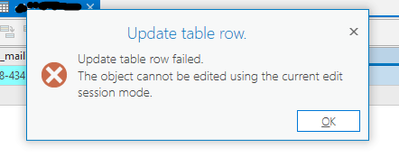

Hello,
I have arcgis pro 2.7.1 and sde.
Please see screenshot and advise. It is sde feature class. Thank you for your assistance.
Alex
AlexP_
I found out I have other application open with same data and data network has been disconnected. I had to close it.

Sadly
160557: The object cannot be edited using the current edit session mode.—ArcGIS Pro | Documentation
quit editing, stop the program, reboot the computer ... not the solution I suppose, but you didn't indicate what you tried
AllenDailey1
I also got this error, and for me, the solution was this:
I had added a new feature class to an enterprise geodatabase in a dataset, and this undid the original settings like making the geodatabase versioned.  So I eventually found that I needed to re-enable versioning for this enterprise geodatabase.  This solved the problem, and I was then able to edit the feature class.
KMuthRC
This solved it for me.
bwvick
Adding a comment that Allen's solution worked for me as well.
