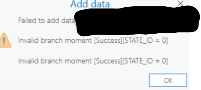

However, when trying to pull in branch versioned data into Pro, we get this error.
Any thoughts on how to address this Invalid branch moment issue?
