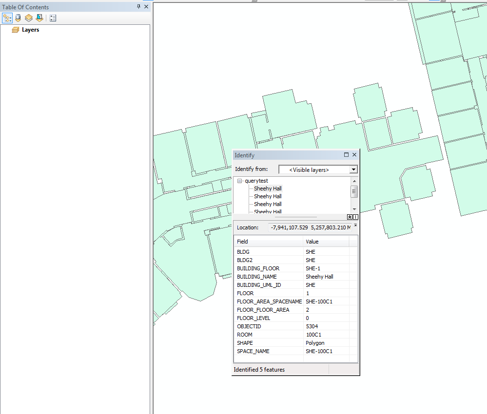

Hi,
I am using ArcMap 10.4.1.  If I go to File -> Add Data ->Add Query layer I can fill out everything, validate it, and hit ok - then it starts to run and ArcMap Crashes.   I can use the "Make Query (Data Management)" Tool and successfully create a Query Layer, but it does Not show up in "Layers" in the TOC .  See Screenshot.
The data is there, and I can use the identify tool to get information about the polygons.  If i switch to List by Source, Visibility, or Selection in the TOC, sometimes the Query Layer will appear there and sometimes it won't.  If I open an existing mxd with a query layer already in it, I can modify the Query and everything functions correctly.  Any thoughts as to what is going on?

PamelaLocke1
have tried exporting, and the new feature class throws errors.  my coworker can create the same query layer with no issue....wondering if it's my ArcMap..
