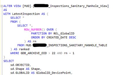

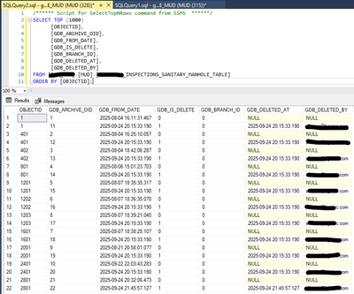

There is a view that returns only the most recent Inspection Record for each point that is causing the issues for me. In this view I can still see all records including deleted records. I have tried filtering out the table by the GDB_IS_DELETE, but not all of the deleted records have GDB_IS_DELETE = 1 (some are 0). My current fix is janky at best and is just filtering out the deleted records from the view using GDB_ARCHIVE_OID > xy.
Here is a list of the archive table fields and their contents:
GDB_ARCHIVE_OID - OIDs (current work around is to filter lowest values out)
GDB_FROM_DATE - Date/Times (All have values)
GDB_IS_DELETE - Not all deleted records match, there is a mix of 0s and 1s
GDB_BRANCH_ID - all equal 0
GDB_DELETED_AT - some have the time/date some are null
GDB_DELETED_BY - some have the usernames some are null
Maybe it is a problem with how the table was triggered when the deleted occurred because all of the "GDB_IS_DELETE", "GDB_DELETED_AT", and the "GDB_DELETED_BY" should have values that are exactly the same.

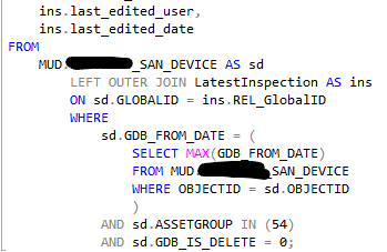

Can you share the SQL you are using for the view?
BGEGIS
Sure! Its starts like this:
then it adds the fields needed from the device and inspection tables and reformats the domains to text then ends with this:
Thanks for your help, but my original post is about how the Prune Branch History tool is not working properly.

Your views don't appear to be filtering out rows from default, which could be causing some of the problems that you're seeing. The rows in non-default branches may have newer gdb_from_dates that the rows in the default version.
In terms of verifying that everything is really being pruned, it's hard to do that without looking at the contents of your system tables and comparing them to the table(s) in question. You may need to open a support case on this one.

Here is a screenshot of the table after the Prune. All 22 records are still there.

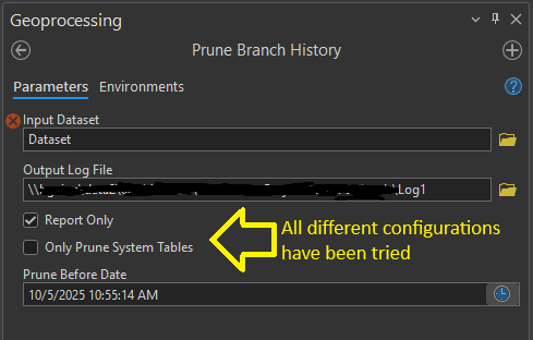

RobertKrisher
Can you post the command you're using to prune? I notice in the initial post it looks like when you're pruning you had the option to only prune system tables checked. If you run the tool with the "Report Only" option and "Only Prune System Tables" options unchecked, it should prune all user and system tables.
BGEGIS
I was using the Pro tool-box "Prune Branch History". I tried all of the different configurations possible with the results displayed below:

RobertKrisher
@BGEGIS
I only see three of the possibilities listed above, what about the fourth option of leaving both boxes unchecked? What I'm suggesting is that you run it with the Report Only box unchecked (so it will actually prune) AND the Only Prune System Tables box unchecked (so it will prune the data in the user tables).
