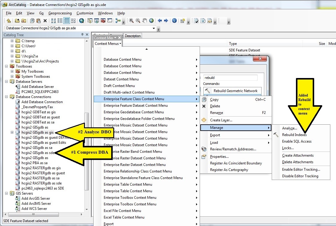

This conversation initiated my question: https://community.esri.com/docs/DOC-9914-compress-geodatabase-tool
One of my weekly tasks is to Compress the server geodatabase then Analyze each feature and I like to do this manually.  The above thread mentions "Rebuilding Indexes" but I've not initiated that process.
I wanted to make sure, are the proper steps after a compress; Analyze/Rebuild or Rebuild/Analyze?
See this image for details.Catalog Screen Capture

Check out:
Recommended version administration workflow—ArcGIS Help | ArcGIS Desktop
Use Python scripting to batch reconcile and post versions—ArcGIS Help | ArcGIS Desktop
And from a class I took in January (copied from the workbook):
This workflow can be incorporated into a model within ModelBuilder
and automated using a Python script to run at appropriate intervals.
The following geoprocessing tools may be of assistance:
   • Compress (Data Management)
   • Rebuild Indexes (Data Management)
   • Analyze Datasets (Data Management)
That should just about do it....
