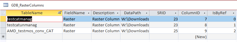

In Version 9 (only has raster catalogs):
Spoiler
In the GDB_RasterColumns table, it shows I have a managed (testcatman) and unmanaged (testcatunman) raster catalog. Note: They have the exact same component files.

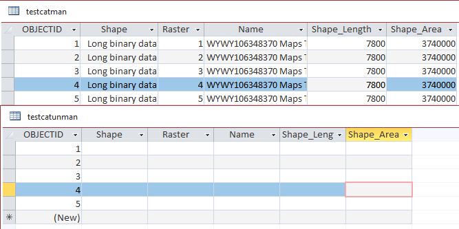

Opening the table for each one, the managed one lists the component files, while the unmanaged one has a record for each file, but it's completely blank.

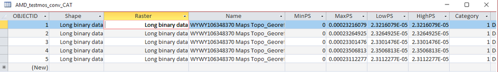

In V10, I have a managed, unmanged raster catalogs, and a raster mosaic (AMD_testmos_conv_CAT)

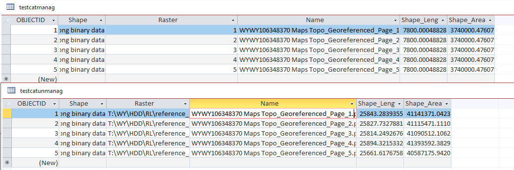

It doesn't look like we have the same problem with raster catalogs as we did in V9:

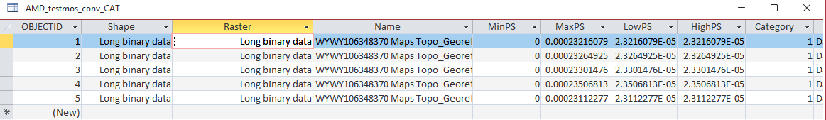

However, the mosaic does not have a nice file path for the files; it instead has that information in a binary field.
Is there an easy way to get the path, or do I need to parse binary?
