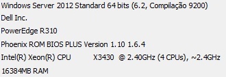

I would like to know if there are some reporting about performance issues on ArcGIS Server 10.4 Workgroup and SQL Server Express 2012 SP4. The server machine specification is showed below:
We have a polygon layer (parcel) with numbers of about 200.000 features. This layer has many relationship classes (something around 6 tables with 200,000-300,000 records each).
We did all spacial and traditional indexes and nothing solved the performance issues.
Our time response revolves arround 5-7s on each pan on the map.
