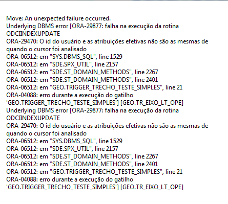

Hello, I started receiving this error after creating a compound trigger in one of our features, in a oracle 11g database, the sde version is 10.4.1
Trigger code :

Image of the stack trace (Couldn't copy it from arcmap) :
