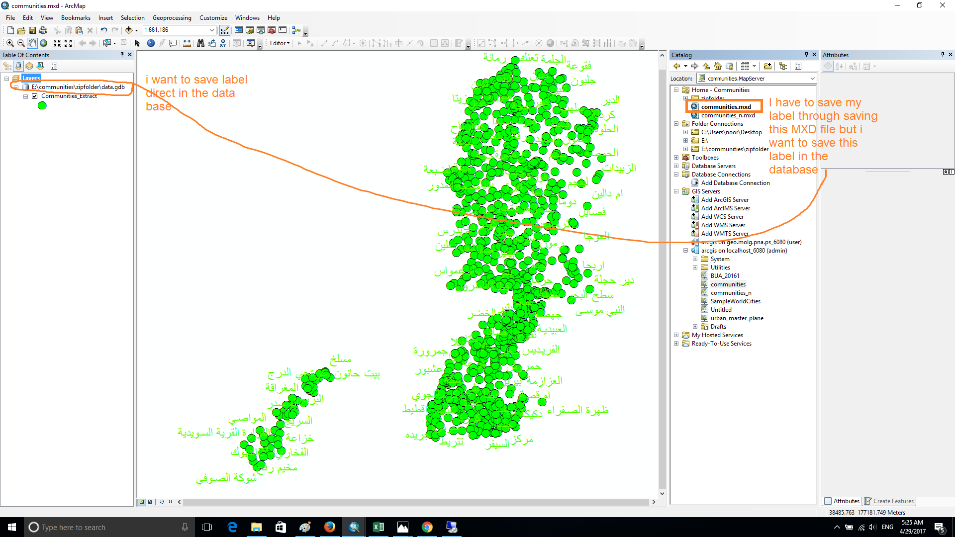

Is there is a way to save label direct to the database??!!
2363
5
04-28-2017 07:34 PM
noormoqady
Is there is a way to save label direct to the database??, in fact i have to save the label i want through save the MXD file but this is not practical for me, if i lose the MXD file i will be forced to start from from scratch with the label.
Kindly find the attached photo.
Best,
Noor Moqady

You could convert the labels to (feature-linked) Geodatabase Annotation (Annotation feature class).
What is annotation?—Help | ArcGIS Desktop
Converting labels to annotation features—Help | ArcGIS for Desktop

noormoqady
Thanks Jayanta Poddar for reply,
I try Geodatabase Annotation, but it does not work with me as in the attached photo.
what might be the issue??

Uncheck the Append option. Append is done only on existing Annotation feature class. For a new Annotation feature class, you need to uncheck the append option.

its work fine at label level, sorry i forgot to elaborate that i need to keep label and symology together (cartography level) and save them directly to database.

Another option is saving the point layer (with appropriate labels) as a layer file (.lyr).
Save To Layer File—Help | ArcGIS for Desktop
Saving layers and layer packages—Help | ArcGIS Desktop
