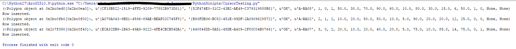

This is the output I get in the output window upon running the script:

I have solved this issue, it appears there's a bug (shocker!). The float fields are the culprit, let me explain.
In the shapefile I had set precision and scale of the field to 3 and 2, respectively. Unfortunately, these are reverted to 0 upon clicking "Ok" when adding the field (if I right-click the field and go to properties, I now see precision and scale are both 0 which isn't how I set them).  Shapefiles are supposed to support precision and scale as per documentation here Working with fields in shapefiles by adding a field in ArcCatalog—Help | ArcGIS Desktop . This is the bug.
My target SDE table class for inserting rows also had the matching float fields with precision and scale set to 3 and 2. This did not revert to 0, so now the scale in the shapefile float fields is much larger than the scale in the SDE feature class float fields.
Because it reverted to 0, my float field in the shapefile is now interpreted by arcpy as having a much larger scale than it's supposed to, so when I try to use an insert cursor to take data from the shapefile and insert it into my SDE feature class fields, the float fields won't work, because the scale is too large, thus it won't copy ANYTHING over and it won't give you an error message either. For instance, my shapefile attribute table has a row where the float field value is 23.2. In arcpy, if I print that row, the value is interpreted as "23.2000000762939453" (how it derived such a number I do not know). Because my SDE feature class matching float field has a scale of 2, it will not accept such a long numeric value and will act like it's inserting rows but it isn't.
The only way around this is to set my SDE feature class float fields to a precision and scale of 0 which isn't ideal, but it does allow the process to carry out successfully.
