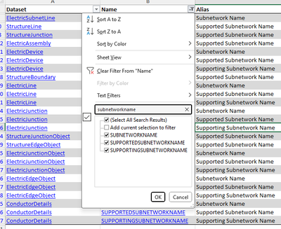

Using the Generate Schema Report tool to create an xlsx schema report gives you a table that lets you answer this question without needing to write any Python:

RobertKrisher
