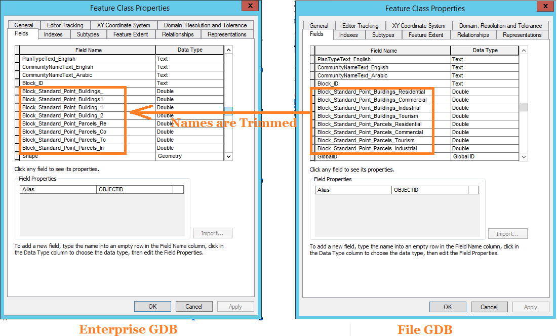

When I copy a feature class from file GDB to SQL Server enterprise GDB, some fields (their names contain more than 33 characters) are trimmed in the enterprise GDB.
What is the allowed field name length in enterprise GDB? Can I change it?

Hi Hani,
Unfortunately, field names are limited to 31 characters for SQL Server geodatabases:
Enterprise geodatabase size and name limits—Help | ArcGIS for Desktop
However, the field alias can be greater than 31 characters.
