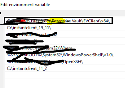

Amjad_Bahati
Dear All
I tried to use many solutions to fix this issue... I instilled 64- bit client for ArcPro I reinstalled ArcPro but I got an unknown error !! it is different from the previous error please see in below picture
George_Thompson
Esri Notable Contributor
Did you put the 64 bit client before the 32 bit client in the PATH variable?
Are you using TNSNAMES or EZConnect for the instance field?
--- George T.
Amjad_Bahati
yes, I've put it 64 before ...
I am using TNSNAMES ..
George_Thompson
Did you configure the TNSNAMES for the instant client following this article?
https://support.esri.com/en/technical-article/000011850
--- George T.
