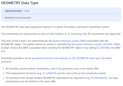

Dan_Joyce_OE
I dipping my toes into Snowflake for the first time and had the same question regarding coord system for the Geography objects...from the doco it looks like WGS84 geographic is the default.
The Geometry object looks like it can accept projected coordinate systems.
