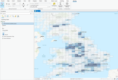

I've been doing a bit of testing on this and have pretty good performance using ArcGIS Pro (3.2.2).  I loaded GB Address Point data - 30.4 million points into Snowflake.  I have an X-Large warehouse and importantly my Snowflake is hosted in the UK - EU (London) as that is where I am too using ArcGIS Pro.
I enabled Binning on the dataset using ArcGIS Pro, and at small scales the bins work well to aggregate the data:

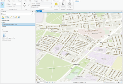

Then when zoomed in beyond the binning threshold it draws the individual addresses pretty quickly:
