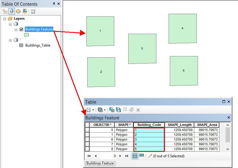

1-      I have a feature class for buildings in an enterprise Geodatabase (SQL Server Geo-Enabled database) that contains a field “Building_Code” that identify each building

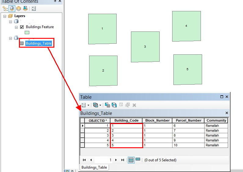

2-      I also have a stand alone table for the same buildings in an Oracle enterprise database (Not Geo-enabled), which also contain the “Building_Code” field
3-      I want to establish a relationship (as I used to do with relationship classes) between the feature class (as origin) and the stand alone table (as a destination) based on the “Building_Code” field.
