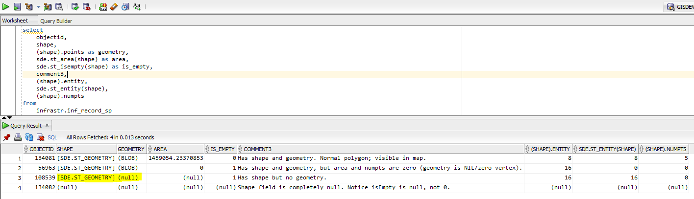

It seems like there are four different states a feature can be in:
  1. Has shape and geometry. Normal polygon; visible in map.
    • Geometry's points blob can be considered a list of coordinates like "(1,2 3,4 5,6)".
  2. Has shape and geometry, but AREA and NUMPTS are zero (geometry is NIL/zero vertex).
  3. Has shape, but no geometry.
    • Geometry is null.
  4. Shape field is completely null.
    • Geometry is null.

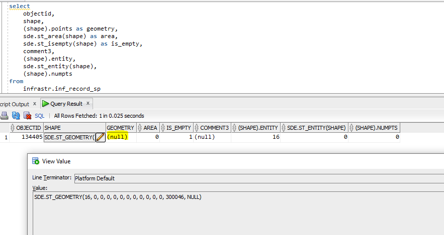

I think I found a way to do it using SQL:
insert into infrastr.inf_record_sp (objectid, shape) values (
    sde.gdb_util.next_rowid('MY_OWNER', 'MY_TABLE'),                     --objectid
    sde.st_geometry(16, 0, 0, 0, 0, 0, 0, 0, 0, 0, 0, 0, 300046, null)); --shape
commit;
https://desktop.arcgis.com/en/arcmap/latest/manage-data/using-sql-with-gdbs/next-rowid.htm
I can query the new row to see what it looks like. It is in state #3.
If I edit that row using ArcGIS Pro (even just edit a non-spatial field), then Pro will automatically change it to state #2: geometry is not null.
