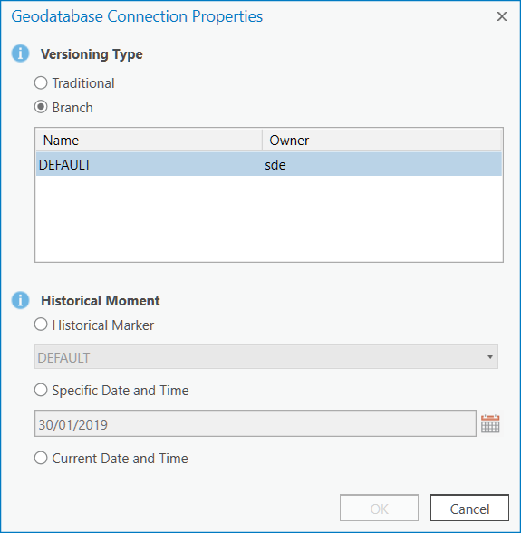

Hi,
I have an Enterprise Geodatabase in SQL Server 2016 and I am building Utility Network using ArcGIS Pro 2.2. My geodatabase is created as DBO owned schema and not as SDE owned schema. When I set geodatabase connection properties with versioning type set to Branch, it sets the version name as DEFAULT and owner as "SDE" and does not let me choose different owner. I do not have SDE log-in or SDE user in the SQL Server database. Will any functionality be affected if I start using branch versioning without SDE user in the database?

It is by design to have the SDE user owner of the DEFAULT version when working with branch versioning.
However, this does not cause any problems if it is a DBO owned schema geodatabase.
I believe the reason to display "SDE" as the owner is for security reasons. If "DBO" was listed then this would inform people that SQL Server is being used and this could be a security issue. Also, DBO comes with security issues in general since any user with the "sysadmin" fixed server role can become DBO.
Overall, having a DBO owned schema geodatabase is supported with Branch Versioning.

I have been able to publish a Utility Network to ArcGIS Enterprise as feature services using Branched Version, have been able to create new versions, perform edits, reconcile and post to DEFAULT etc. So all working so far with DBO owned schema. It seems that owner of the DEFAULT branch version is "hardcoded" as SDE, like a keyword without a need for this user/owner to exist in the database.
I just want to know if DBO owned EGDB is supported for Branch Versioning and something is not going to bite me later in the production system.

As confirmed by others, DBO owned schema geodatabase is supported with Branch Versioning.
Understanding the Default branch version:
In a DBO schema geodatabase, the sde.Default version refers to the Default branch version and DBO.Default refers to the traditional Default version.
In Branch versioning, versions are created and managed differently from Traditional database versions. In traditional versioning, database users create and own versions whereas in branch versioning, versions are created within feature services (or Utility network service) and managed by a version management service. So these branch versions are owned by the portal user connected to ArcGIS Pro, at the time they were created. You can compare the  Owner column in the SDE_Branches table and the SDE_Versions from SQL Server management studio to clarify the concept.
Since the Default version is created by the system when the geodatabase is created, the SDE keyword under the owner column in the system table Branches, is most likely meant to indicate this concept.
