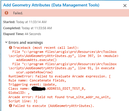

But then I tried to add calculate geometry tool and add geometry attribute tool manual. I got both same error.
