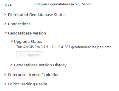

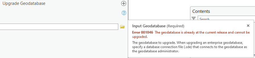

I am currently working on creating a utility network locally as a proof of concept. The geodatabase version must be 10.8.1.2.6 or later. However my geodatabase is at 10.0 and I get the message "This 10.0 geodatabase matches the ArcGIS release you are currently using."  Our Enterprise geodatabases are at 11.1.0.41833 and I am not give the option to Run Upgrade. When trying to upgrade with the tool I get the error:  001046 The geodatabase is already at the current release and cannot be upgraded.

@TommyJackson - It seems you are using Pro 3.1.5, the screenshot for the File Geodatabase shows 10.0, there is no upgrade for file geodatabases, the screenshot for the SQL Server Geodatabase shows the ArcSDE Repository at 3.1.5 - 11.1, and that matches Pro 3.1.5, hence the SQL Server Geodatabase ArcSDE Repository does not need upgrade. I hope this clarifies.

File geodatabase hasn't really changed since 10.0 (vice the 9.x architecture). There have been types added, the use of which would make older clients not recognize those tables, but the underlying format hasn't changed, and there isn't an upgrade procedure for them.
