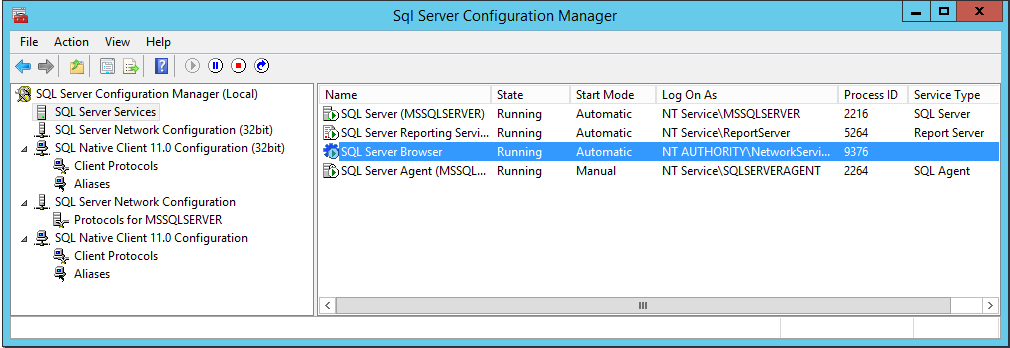

I also read about enabling all services that MSSQL should run. So, I headed over to the SQL Server Configuration Manager and indeed, 'SQL Server Browser' and '.. Agent' were not running. I started them but realized smth weird in 'SQL Server Browser' properties:
- I have no idea which 'account' to specify. If 'Built-in Account' or a domain account. Currently it's 'NT Authority\Network Service'
- Also there's no 'SQL Service Type' specified, which seems to be the case for the other running services.

What your image shows is the account running the SQL Server software.  I would not change this if possible.
