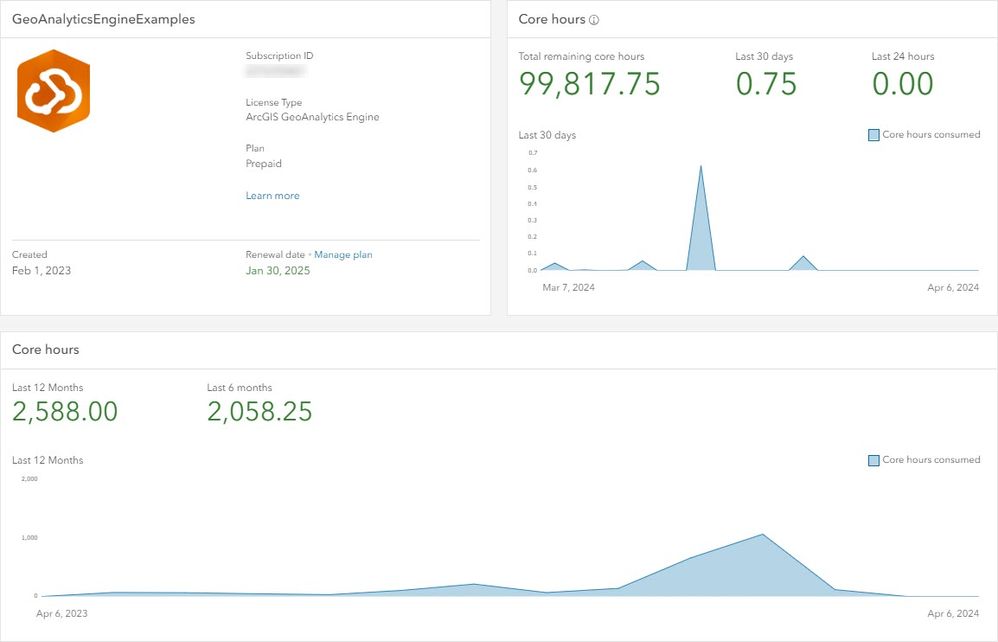

There are two easy ways to track your usage. You can use the GeoAnalytics Engine dashboard associated with your account to view the overall usage and graphically explore your past usage. Note that this dashboard isn’t updated immediately as the data is collected and there may be a short lag between completing a process and the dashboard being updated.
The GeoAnalytics Engine Dashboard for tracking core-hour usageThe GeoAnalytics Engine Dashboard for tracking core-hour usage

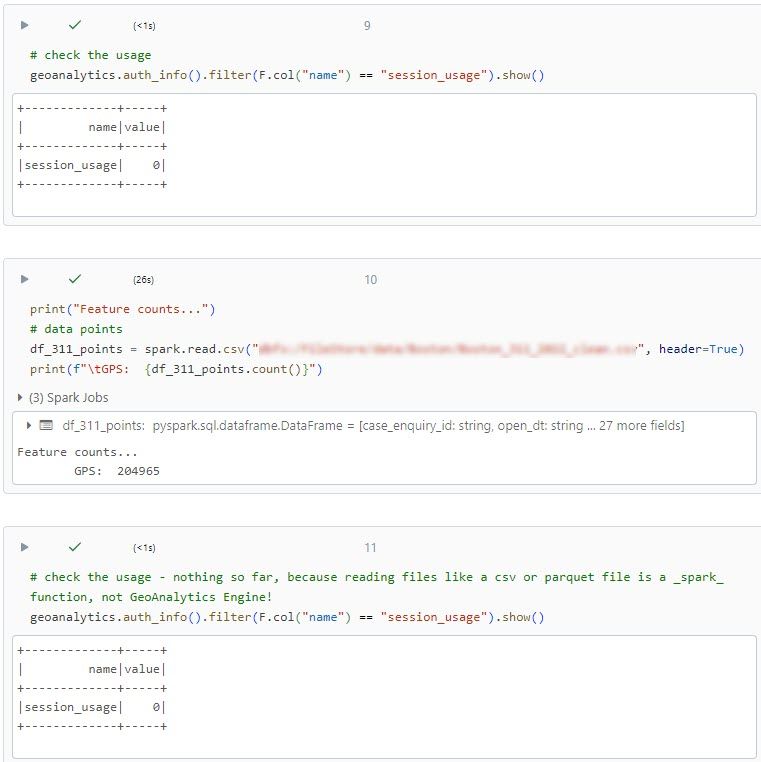

Before I run any operations, I can check the number of core-milliseconds used (reporting via auth_info() or usage() is always in core-milliseconds, even though the overall unit for the Connected license is in core-hours), and then as I complete operations, I can see what has been used.  In this case, I started at 0, read in a csv and the usage is still 0 – because reading CSV files is a Spark function, not a GeoAnalytics Engine-specific function.
Reading in a CSV of data does not use any core hours as it is a spark function, not specific to GeoAnalytics Engine.  The graphic shows 0 core milliseconds usedReading in a CSV of data does not use any core hours as it is a spark function, not specific to GeoAnalytics Engine. The graphic shows 0 core milliseconds used

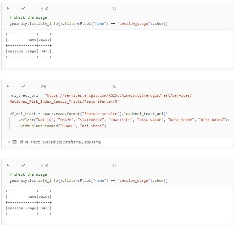

On the other hand, if I read in an Esri feature service, we would expect that the session usage to increase since reading feature services is a GeoAnalytics Engine-specific functionality.  Let’s see what happens:
Example of reading in a feature service. The core milliseconds used did not change.Example of reading in a feature service. The core milliseconds used did not change.
After reading the feature service the session usage is still 3475!  This is an important thing to note – Spark uses lazy evaluation, so when we “read” that feature service, we didn’t actually “read” it.  What??

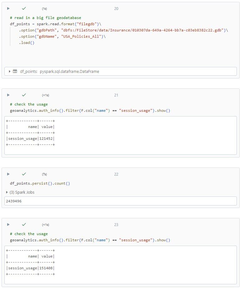

Let’s add in a bigger spatial process to explore core-hour usage.  For this, we’ll perform a reasonably sized spatial join with a about 2.4 million point records and the ~85,000 tracts we just read in from a feature service.  First, we’ll read in a file geodatabase, then persist that data frame.  That takes our session usage to 151,408 core-milliseconds, or 0.042 core-hours.
Example of reading in a geodatabase and persisting the dataframe.Example of reading in a geodatabase and persisting the dataframe.

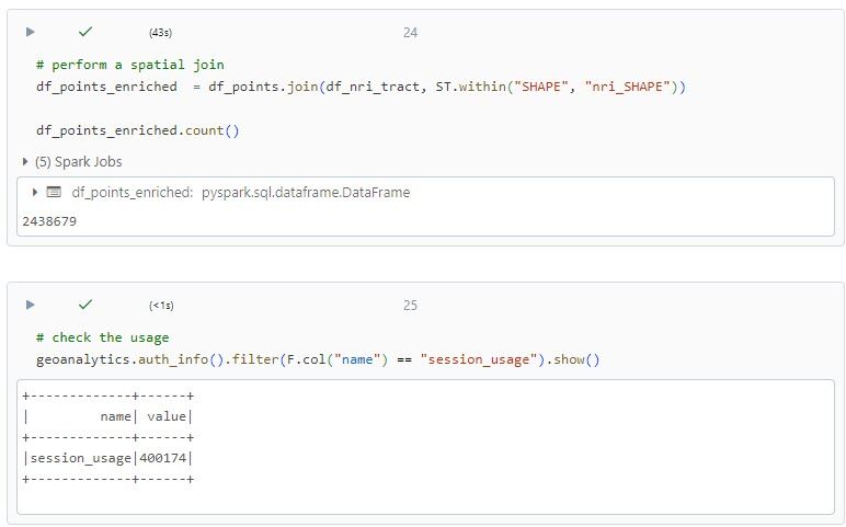

After running a spatial join using ST_Within, our total core-millisecond usage for the entire workflow is at 400,174, or 0.111 core-hours.
Example of performing a spatial join with ST_WithinExample of performing a spatial join with ST_Within
