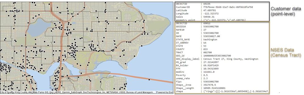

The first example we’ll look at is one of the most basic: augment our point data based on the polygon in which they are located.  For instance, if we want to understand the socioeconomic characteristics of customers with the largest annual purchases, we can use a spatial join to assign new attributes to our points, based on the census area in which the customer resides.  To do this, we can enrich each of our customer points using the US Census Bureau’s American Community Survey census tract-level data for Neighborhood Socioeconomic Status (NSES) that is available through the ArcGIS Living Atlas.  Feature Services from the Living Atlas, or other ArcGIS services, can be read directly by GeoAnalytics Engine to create a data frame for use in analyses.
Points enriched based on the census tract they are withinPoints enriched based on the census tract they are within

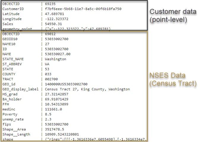

Utilizing the ST_Within function in our join results in a new data frame with each of the customer points enriched with all of the NSES data. For example, here is one record:
Attribute table for a single enriched pointAttribute table for a single enriched point
As an interesting side note, it is worth mentioning how GeoAnalytics Engine streamlines the process of working with spatial data.  Take note of the attributes mentioned above for the “geometry_point” (bottom of the black box at the top), and the “shape” (bottom of the yellow box).  The point data for the customers use coordinates of latitude and longitude (in WGS84), while the polygons from the NSES feature service are in web Mercator coordinates (meters).  We didn’t have to transform the coordinate system for our data frames to perform the spatial join because GeoAnalytics Engine can project the data on the fly.  The spatial intersection is calculated correctly when the coordinate systems are known for all of the inputs.

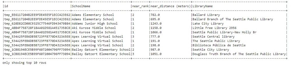

This will find up to the three closest libraries (setNumNeighbors) within 1 mile (setSearchDistance) from each school, giving us a result in long format like this (multiple records for each school; one for each library that is nearby):
Nearest neighbors results, long formatNearest neighbors results, long format

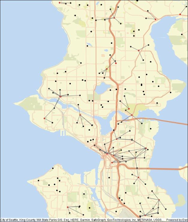

We can also look at the results as a map to see the distribution of schools (black) and libraries (red), with connecting lines showing the closest to each school.  We can do this in GeoAnalytics Engine using the results from our Nearest Neighbors calculation. Since each result row in the table has the geometry from each input (Schools & Libraries), we can simply connect the points for each using the ST_ShortestLine function:
# plot the schools
plt = seattle_schools.st.plot(**sea_style, color="black", marker_size=10)
# create the connector lines
libraries_near_schools.select(ST.shortest_line("geometry","geometry1"))\
.st.plot(ax=plt, linewidth=1, color="grey")
# plot the libraries
seattle_libraries.st.plot(ax=plt, color="red", marker_size=12)
Nearest neighbors as a mapNearest neighbors as a map

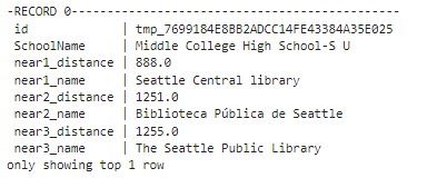

This results in a table with all of the new distance attributes to enrich our original schools data with library proximity details – here is an example of one record for the Middle College High School and the three closest libraries:
nearest neighbors result joined to schools datasetnearest neighbors result joined to schools dataset

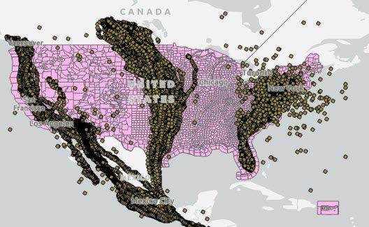

For this example, we’ll use the Movebank Vultures Acopian Center USA GPS (2003-2021) data and five years of data from the National Weather Service watch, warning, and advisory events made available from the Iowa State University Iowa Environmental Mesonet.   The vulture dataset involves almost 2 million records with location and time tracked and recorded for 78 individual vultures. The NWS watch, warning, and advisory data for 2010-2014 has 2.1 million records.
vulture migration, storm watches and warningsvulture migration, storm watches and warnings

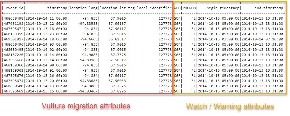

This identifies 70 times when vultures were near or within an active watch or warning and enriches the vulture dataset with the details for the matching watches and warnings. At this point we have an enriched data table that provides details like this:
vulture migration data enriched with watch and warning datavulture migration data enriched with watch and warning data
We can also see the results graphically, with the relevant watches / warnings (red) mapped with the vulture tracks (green points and grey lines) and the times when the vultures were near to an active watch / warning (black points).
vulture migration with weather watch or warnings near in space and timevulture migration with weather watch or warnings near in space and time

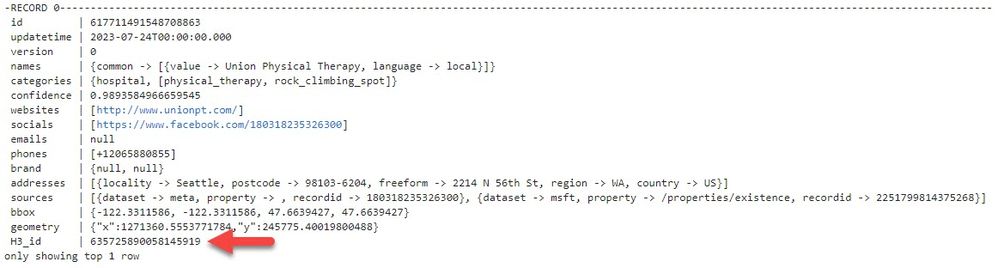

As an example, we’ll add an H3 ID to the Seattle places data from Overture Maps Foundation that we looked at when we explored enriching by proximity.  If I wanted to add an H3 ID for each of those points it would look like this:
df_places_seattle = df_places_seattle\
    .withColumn("H3_id", ST.bin_id(ST.h3_bin("geometry", 13)))
A resolution of 13 was used for this example, which has an average hexagon size of 43.8 m^2. You may want to pick a resolution with larger or smaller hexagons depending on your need.  A nice chart with the details on the different resolutions is available here in the H3 library documents.
Once the new column has been added to enrich our points with H3 ids, we have a result that looks like this, and it’s now ready to use with Placekey or any other data that includes H3 index IDs.
One location, enriched with H3 identifierOne location, enriched with H3 identifier
