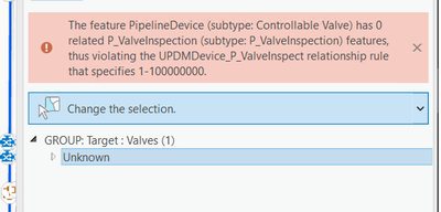

I'm creating valves in a UPDM UN database and get the following error about there being no related valve inspection records present.  (Valve inspection info is kept in another system and will not be included in the UN database).   But when I try to change the relationship multiplicity (below) it looks like no Min and Max values are set.

Can you fill in 0 for min and 1000 for max?

Yep.  Thx.  That seemed to have resolved it.   Not sure why Pro would assume a Min value of 1 if the configured Min and Max values were null, but it appears to.
Anyway, I'll make sure relationships have valid Min and Max values assigned - and that will be my path forward.
