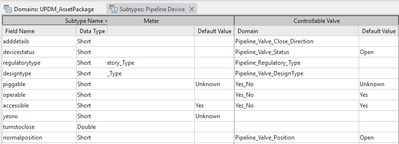

EdwardBlair
Sure.   But as I look at the values in the device status domain they are "active" and "inactive" - which to me implies whether the asset is or is not in service - not whether it is "open" or "closed".  A "closed" valve is very much "active".  Is this just something I'm going to have to get over?
RobertKrisher
@EdwardBlair what version of the model are you looking at? In the latest versions of the model both the devicestatus and normalposition fields have domains that only include the open/closed values.
In earlier models, there was a domain assigned at the class level that also included active/inactive, but the domain assigned to operable devices should only include the values open/closed. As you know, when a class has subtypes, you must look at the domain assigned at the subtype level.
EdwardBlair
Doh!   I'm such an idiot.   Of course its at the asset group/subtype level.   Thanks @RobertKrisher !
RobertKrisher
Don't worry about it, we keep a swear jar of sorts around the office for every time someone forgets to check the subtype 🙂
