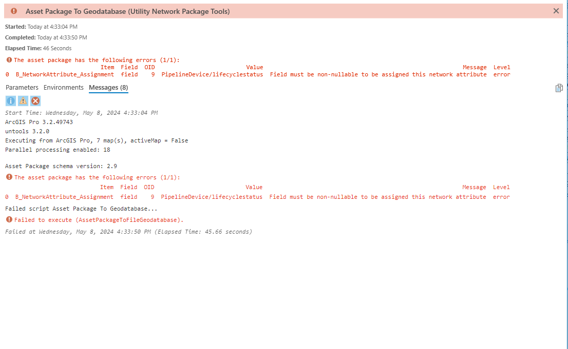

I'm using the latest UPDM and I am using the "Asset Package To Geodatabase" tool. I am stuck on an error and I have exhausted the internet and Chat GPT.

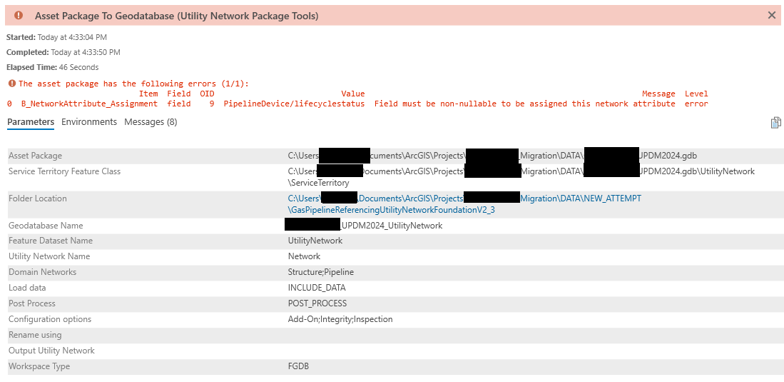

Parameters
Asset Package C:\Users\Documents\ArcGIS\Projects\Migration\DATA\UPDM2024.gdb
Service Territory Feature Class C:\Users\Documents\ArcGIS\Projects\Migration\DATA\UPDM2024.gdb\UtilityNetwork\ServiceTerritory
Folder Location C:\Users\Documents\ArcGIS\Projects\Migration\DATA\NEW_ATTEMPT\GasPipelineReferencingUtilityNetworkFoundationV2_3
Geodatabase Name UPDM2024_UtilityNetwork
Feature Dataset Name UtilityNetwork
Utility Network Name Network
Domain Networks Structure;Pipeline
Load data INCLUDE_DATA
Post Process POST_PROCESS
Configuration options Add-On;Integrity;Inspection
Rename using
Output Utility Network
Workspace Type FGDB
Messages
Start Time: Wednesday, May 8, 2024 4:33:04 PM
ArcGIS Pro 3.2.49743
untools 3.2.0
Executing from ArcGIS Pro, 7 map(s), activeMap = False
Parallel processing enabled: 18
Asset Package schema version: 2.9
The asset package has the following errors (1/1):
Item Field OID Value Message Level
0 B_NetworkAttribute_Assignment field 9 PipelineDevice/lifecyclestatus Field must be non-nullable to be assigned this network attribute error
Failed script Asset Package To Geodatabase...
Failed to execute (AssetPackageToFileGeodatabase).
Failed at Wednesday, May 8, 2024 4:33:50 PM (Elapsed Time: 45.66 seconds)

I tested the last release version of the UPDM and could not repo the issue.  Did you adjust the fields nullability or the network attributes?
Cristian_Galindo
UPDM 2024?  the latest version released is 2023: https://community.esri.com/t5/gas-and-pipeline-blog/utility-and-pipeline-data-model-2023-is-released...
could you check the source of your model?
